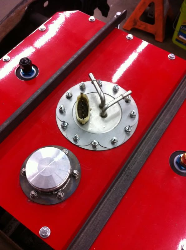

    I thought you might like this, it is what i came up with to run a stock pump in a fuel cell. It is just a cheap Summit fuel cell.
