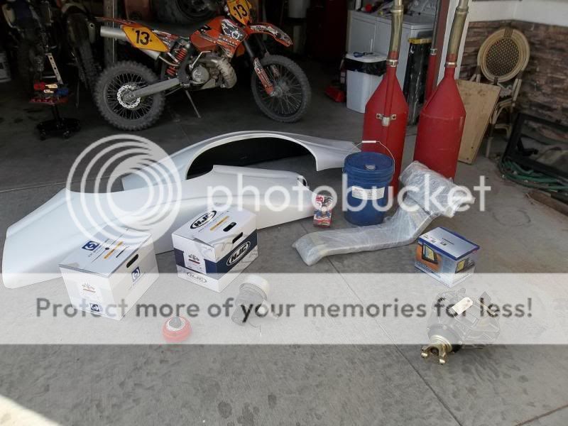

    Picked up a lot of needed stuff at the swap meet a few weeks ago, especially thanks to PCI and Fiberwerx. Also thanks to a few chance pick ups we should have a Currie 9" to pair up with the Strange 3rd and round out the drivetrain.
    At this point we basically have all the major components, just a lot of little nickel and dime stuff left to pick up. All that's left now is the manual labor of putting everything together!
