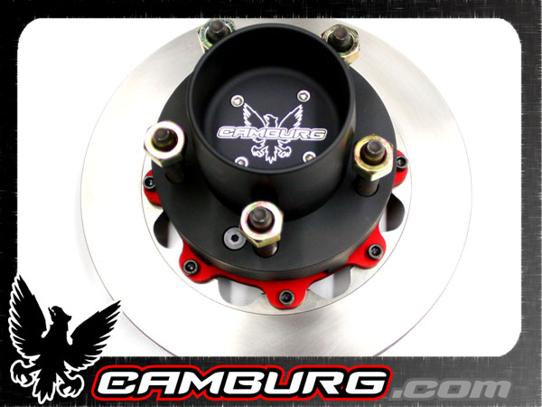

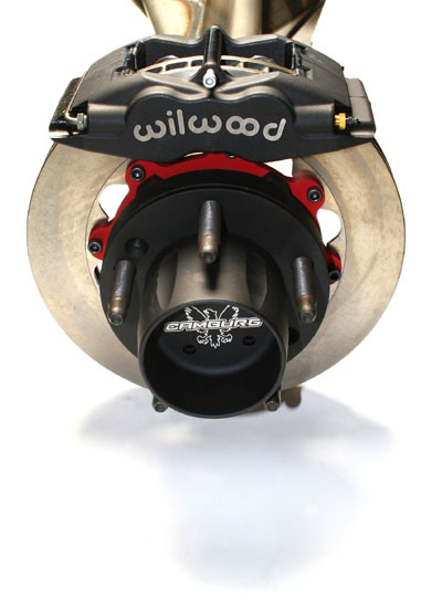

    Our billet rear hub kits include Hubs, bearings, seals, hub centric center caps, lug nuts, 5/8" wheel studs, and hardware. $1395.00 or with a complete 4 piston Wilwood brake kit $1995.00
    They come in 5 on 5.5, 6 on 5.5, and 6 on 6.5" bolt patterns.
    Same hubs that Heidi Steele runs on the class 6 truck and has won championships in SCORE and BITD.

    Jerry, do you sell a 7075 2.5" snout rear hub? If so what is the cost minus brakes? Hubs look nice.
    Yes they are all drawn up and about to hit the machines in a few weeks. I will post CAD pictures tomorrow. They are all the same dimensions as the TT hubs but will be offered in 5 on 5.5, 6 on 5.5, and 6 on 6.5 bolt circles. They will retail for $1595.00 and $1695 for 6 on 6.5".
