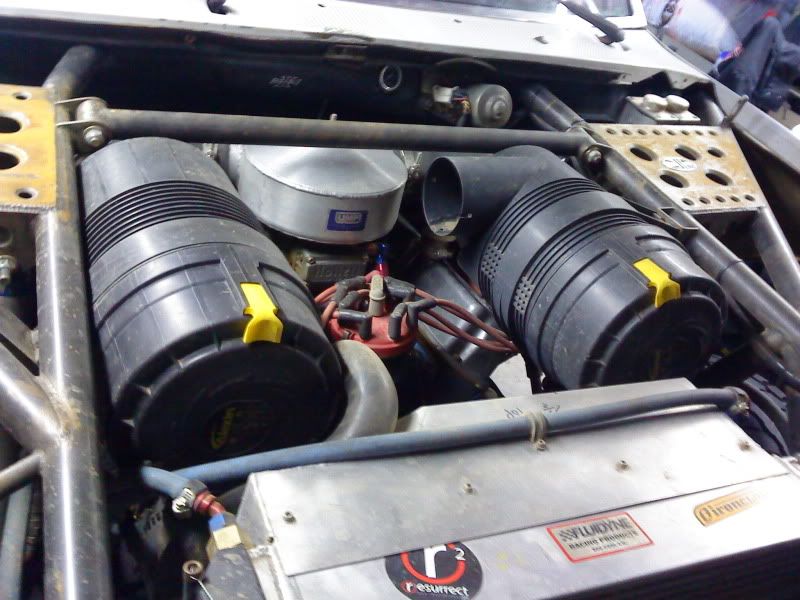

    The UMP one is bigger, could be bigger still.....
    Yeah that one looks close to the same size as my ump one... Maybe I can just cut it and on another inlet and make it a dual myself?

    Unless its super convenient for you guys to test, I'd beg borrow or steal a big air cleaner before heading out just so you have it. I'm still betting that hat is the problem. A big air cleaner will tell you if its the problem, regardless of whether you use it permanently. If airflow does in fact wind up being the problem, THEN you can go thru the effort and spend the money to modify the hat or get a new one.
