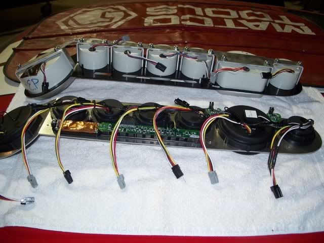

    Oh, and don't get me started on speed hut, I have done two installations with speed hut. A whole lot of wiring to make them work. They have two different lights inside of them, one that is DC and one that is AC. They have a little inverter that supply's AC voltage to the gauge back light. The DC supply's power to the lighted needle, The AC side has a little black box that daisy chains between all the gauges and then gets pos. and neg. from lighting circuit. The only thing I can say that I like about them, is that you can have the face of the gauge printed to say anything you want. You could get the part number printed on the front, so that when you have to replace them, you don't have to take the dash out to get the part number. I truly hate them the most. Sorry

    Just a quick update as I was finally able to get the Humongous in the dirt for a good test of my Speedhut gauges.
    They worked flawlessly and are very easy to read and look bitchin. As for the wiring, the harness that goes to the senders is solid, with metripack connectors at the sender rather than just a single wire with an eyelet connector like on most senders. The wiring for gauge power and lighting was very small gauge however so I took care to bundle it all together and strain relieve it. Other than that it worked fine.
    The GPS speedo acquired satellites very quickly and has some nice functions such as trip odometer, compass heading, 0-60 and 1/4 mile time, etc. It was rock solid the whole trip to Baja and no hiccups with signal even though I just have the antenna on the dash. The only issue with that gauge is that some of the settings require a constant power hookup or it will dump your setting, however it is such low power draw that it would take forever to drain your battery. I didn't have the constant power hooked up but I plan to do that shortly, and I'll just disconnect the battery when the truck won't be used for long periods.
