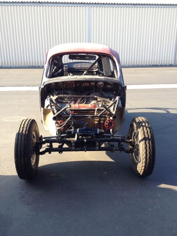

    Starting to go back together into a roller with new trailing arms front and rear... The front end is pretty much all together less steering, and the rear end is back on the wheels ready for the drivetrain to go back in.
    Gotta straighten a tie rod, and put get the rack together then we'll be able to roll the car around again. Currently leaving out things like seats, shocks etc until after paint to improve access.

    Back on its wheels! No more tweaked stance. Jut got our engine back too, so now it's a few odds and ends, bodywork/paint, and reassembly.

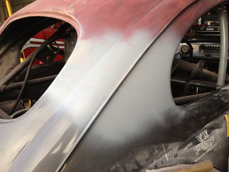

    Been spending most of my time in the shop doing body work, but the exterior is looking pretty good.
    The 5 other new joints are pretty much blended the same.
