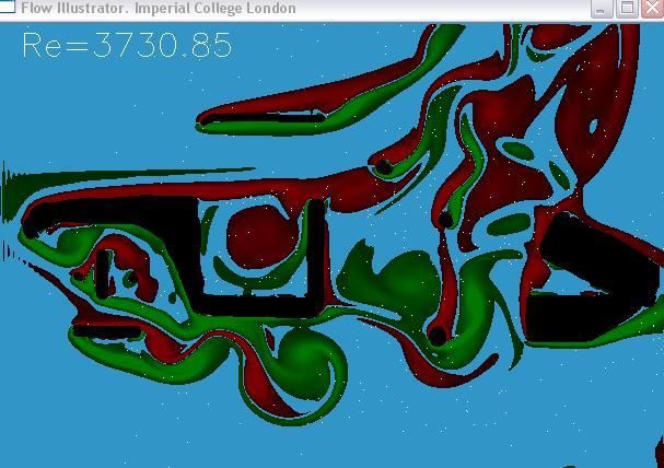

    Re: Aerodynamics in off road racing
    Here is what a Truck would look like if you sliced it between the driver seat and trans tunnel. I think there is definatly some Schmaerodynamics in off road racing for sure.
    Fly thanks for sharing some actual examples on an overlooked detail, what are the differences between the green and red?
    What are the possible improvements that can be made on your truck diagram ?
    Would you want to make the roof like a wing for down force to make the car stick to the ground or would that work against yourself going over areas you are trying to stay on top of like a whoop section ?
    Is it necessary to try and clean up the turbulent air in the rear?
    How would you do that ?
    Quote Originally Posted by Mark Anderson View Post
    In a tt you want the downforce/lift to be even. What you want to do with any surface is use it as a control surface to clean airflow. There is about ten things you can do to the flow in this example to massively reduce turbulence. The red is pressure and the green is vacuum.
    Just curious, (I can't tell) did you take into accound the driver/passenger, the radiators?
    Quote Originally Posted by FlyHiFlyLo View Post
    I agree 100%! The less boxey/sharp the lines on the truck are and the less areas for the air to run into without flowing past, the better the vehicles will slip through the air. You could even design a system to understand where the vehicle is in relation to the ground and the speed, and for unexpected jolts/jumps/etc..you could throw out control surfaces to correct the vehcile trajectory. This may also take a lot of the loads off the suspension.
