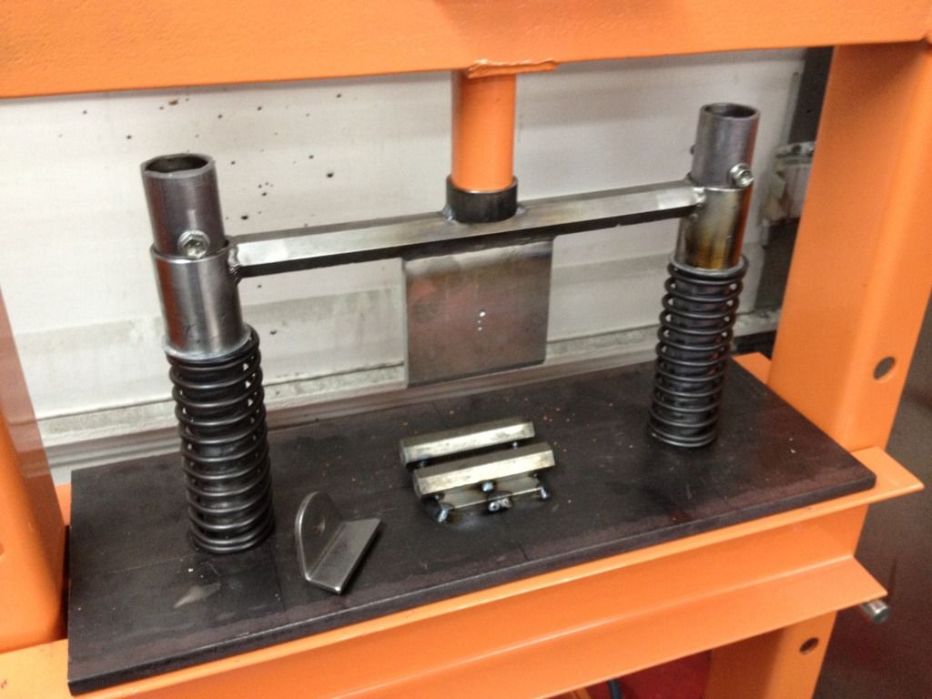

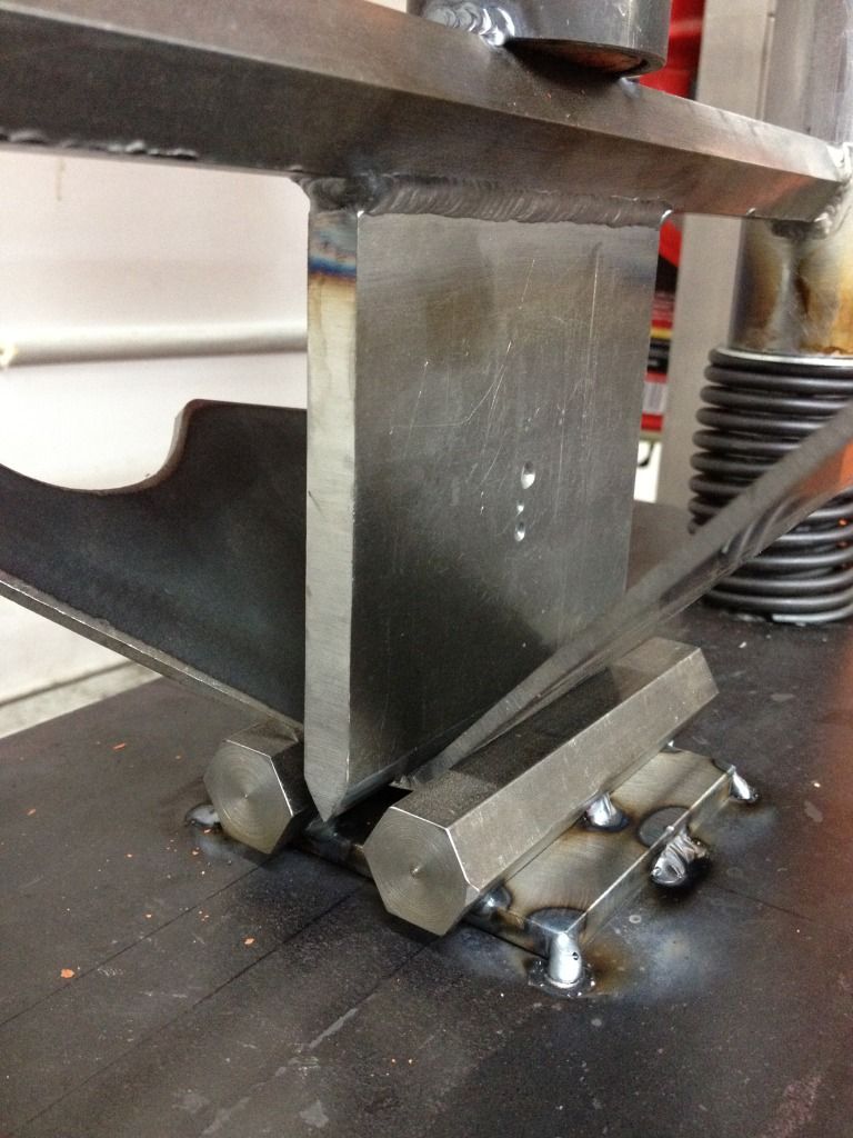

    got tired of the other methods of bending steel and threw this together a few weekends ago. just used what i had laying around the shop to see if my idea for the dies worked. well it worked quite well for tabs and smaller stuff and now need a bigger brake. bends 3/16 steel effortlessly and was even bending 4" wide 1/4" thick aluminum without issue.
    im now working on version 2 , hopefully 16-28" wide die. i know there are units out there for purchase, but i dont like the fact there are only 1 size die made for bending 1/4" and i rarely use that thickness.
    thats being said , id like to see what others have built in the way of press brakes for some inspiration!

    Looks great what size is the hex? and the springs?

    upper hex is 7/8" and lower die hex is 3/4", 1.125" finger width. the spring is mcmasterrcarr part number 96485K156.
    kinda bummed that 1/8" cold roll bar dosent like to bend without snapping. any tricks to bending cold roll without heating it ? i really like to use it for making brackets. but looks like i better stock up on hrpo.
