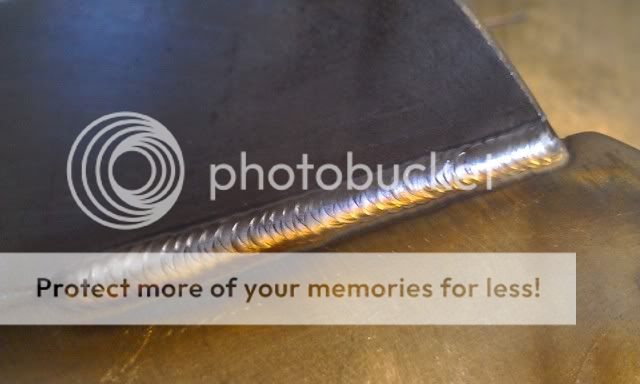

    3.0x16 c/o, 3.5x18 bypass and 2.5 bump .....little miss matched on the colors right now. Blue 3.5s were already in the rear with deavers.
    Got some stuff welded. Still need to weld the pass side radius arm mount, steering mounts (will wait till tierods actually cycle), and a few gussets and pieces here and there. Hopefully steering will be welded and finished before the weekend.
    Finally got a mig going on this project. I was 100% tig, but WAY too much welding in a short amount of time.
