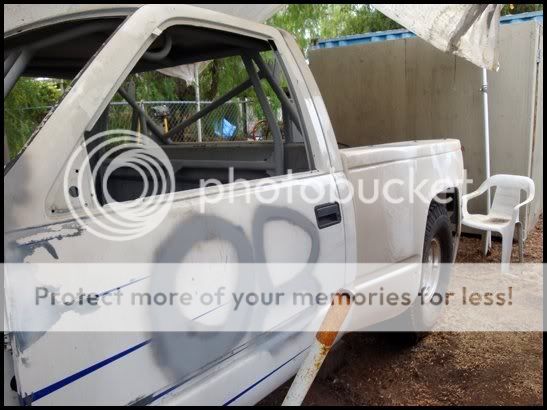

    This is her, the day I was loading her up on the trailer
    You can see how far the cab cage comes from the actual cab. 6"= no good at all
    And of course, the bedcage. At first glance it might not look too bad, but notice the weird shock towers, and bars that don't really serve a purpose... not to mention all the welds sucked... and it was crooked. lol. And the point where the 3rd link met with the axle was weak too... I've decided to junk it all and go with a redesigned 4 link.

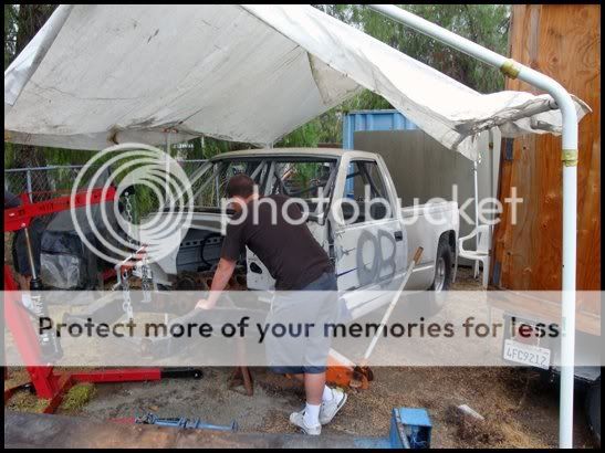

    So since it looked like that, I've plasma'd out anything and everything that came in the truck. Bye bye to bad fab work. Also cut the frame off in the front and added some much needed paint to take care of the eye-sore.

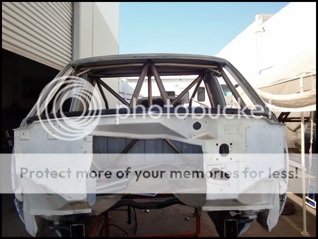

    Front facing view of the cab. Firewall's the next thing to go probably sometime next week

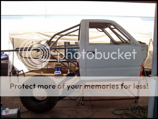

    Side view of the cab, cab cage, and bedcage started. Tire in picture is a 35"... I will run 37's

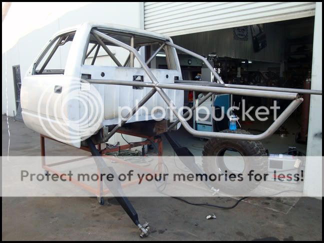

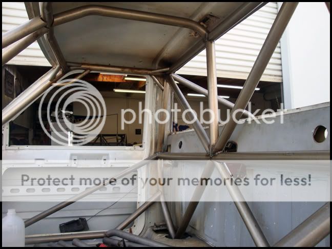

    A peak at the redesigned cab cage. I think it came out a lot better then the old one. It's still not 100% done. I'd like to add some more support bars, truss's, and probably make an "X" where the door is... we'll see

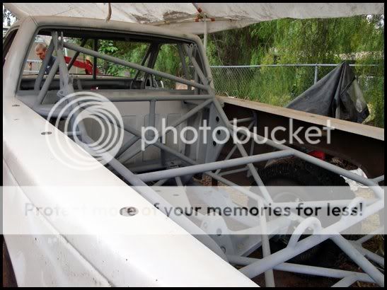

    Better view of the work I have done on the badcage so far. It'll look and function much better than the old one.
    As I'm moving along in the build, I feel like I'm getting much better at tube intersections. I'm learning!
