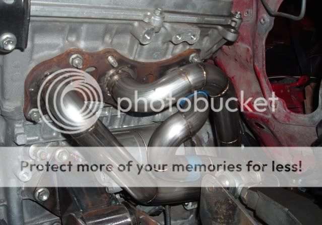

    Well I finally started on the headers today. I got the pasenger side almost done but had to rework the design for the driver side to clear the starter. 5 tubes are within 1% of the 17.75 length and one tube is 2% shorter.
    Driver side. gonna start laying out the tubes tomorrow and hopefully start on the collectors

    And heres the driver side headers. I still need to rework the lowest tube cause its too close to the starter, but no matter what we are way close to the starter and upper heim joint. A buddy is gonna give me some header wrap and Im gonna wrap the crap out of it . . . maybe itll save the starter
