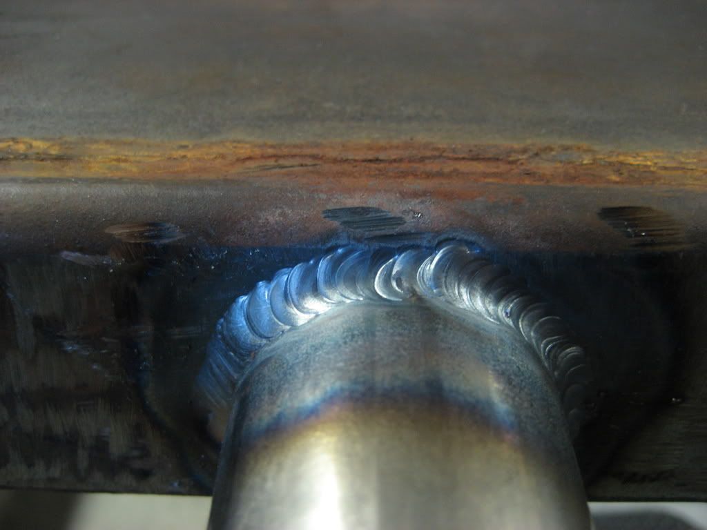

    It's about time I upgrade. I like my Helmet when I am tig welding, but have a hard time seeing when I MIG weld.
    What's a good Helmet to get and why?
    Im just a basic welder nothing special. Using an older lincoln Idealarc 250 for TIG and a millermatic 250xp for MIG

    Your welds look good with what you are using. Removing the mill scale off the material will also help in seeing whats going on. Also remember to keep that tungsten sharp.

    Thanks for the reply. I currently use an auto darkening helmet now. When I TIG the puddle and bead really stand out and give off a nice orange tint, when I MIG weld it's green and I can't see the material I am welding very well so it's harder for me to get a nice clean MIG weld all the time.
    I am self taught, almost ditched the TIG that took a long time to get where I am at today, I don't really have that steady of a hand so Im happy with what I can do. I keep that TIP sharp I also have a dedicated grinder for my tung. I always clean my metal before welding the best I can as well.
