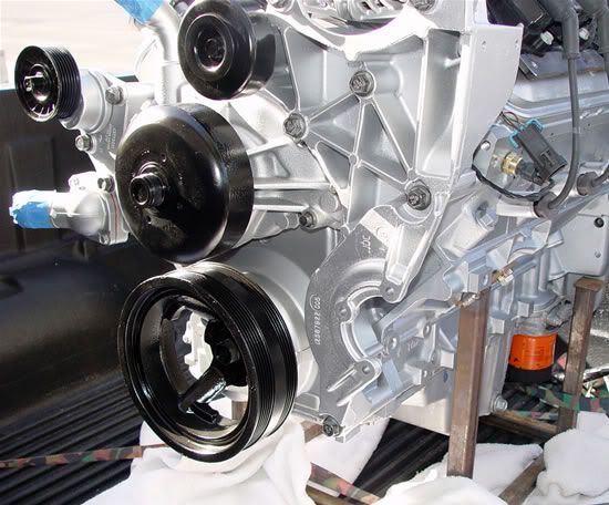

    It sure does look like a similar bolt pattern to the GM Type II but as mentioned, you may want to doublecheck with Jeff before you go buying brackets. I ran into a similar situation with my 5.3l that may give you some more info... or at least a cross-reference. There was no bracket for the 5.3l so I ended up swapping out the bracketry from a 2003 (?) Chevy SSR. The TC210 pump bolted right up, same bolt pattern.

    Do you have the GM par nummber for that^? I was wanting to do something similar to my 5.3
