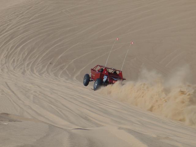

    my experience is mostly in "sand"....but here is my 2 cents anyway ;
    i love turns....and going into turns at speed
    bumps (properly set up) can make a HUGE difference....
    IMHO this pic (of a 4000+ lbs front engine play Truggy i made) is saying more than a thousand words;
    with 4 corner bumpstops (if you look close you can see the front one poking out over the A-arm) you can have a comfortable ride AND charge into a steep transition like that at great speed and take a lot of momentum into the turn ..... without bumps you have to take sharp transitions the (slow) old fashioned way: lift the throttle, take the transition and then "point and shoot" out of the turn.
    IMHO i think the front sway bar is also a great tool to fight the "bottoming out" of the (outside turn) front tire
    Stephan ..................................... "In a totally sane society, madness is the only freedom" J.G. Ballard

    Quote Originally Posted by RoosterBooster View Post
    RL
    would you please post some close up pictures. Sounds like the set up I need. For example in Barstow can ride all day long no issues, go to Glamis and within 50 miles of driving the shocks are leaking...
    Thanks in advance!
