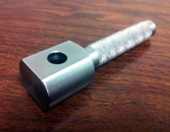

    Erik, I have been looking into jacks also and the options seem limited, IMHO. I decided to go with a "hybrid" bumper jack. Basically, I machined a pin from 1144 and turned a handle/base plate from 6061. The mounting plates are made from P/O steel. I then hacked away at the bumper jack removing everything un-necessary and all will be attached with "Quick-Fists". I'm finishing up making a few for friends and hopefully will pan out, total weight of jack is 10 pounds 5 ounces (completed weight).
    Not that you will want to do the same but keep your options open...

    Thanks for the replies guys! Desertguy looks good! What is the jack ratchet portion from?

    Quote Originally Posted by ErikIrvine View Post
    The bumper jacks that I have bought have been NOS items from eBay. They are all 70's to 80's GM jacks, with a little sifting, you can find NOS jacks in the 30.00 to 50.00 range.

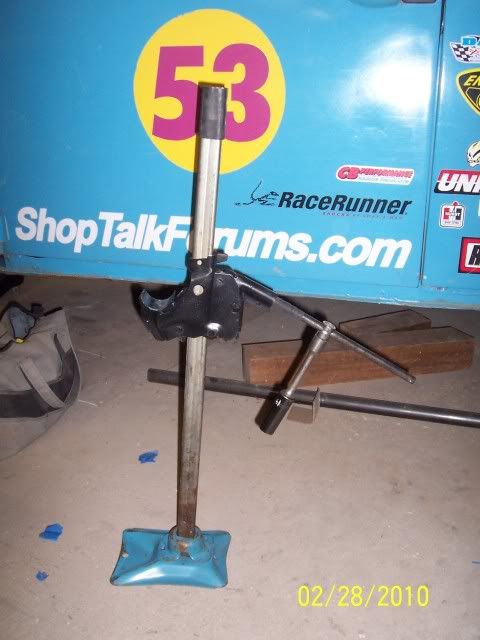

    here is my jack... modified to fit the front beam or rear engine cage of my baja. still rocking the stock baseplate color... buick/olds/pontiac/chevy, whatever it came from.

    Quote Originally Posted by bajaherbie View Post
    you can not beat one of those jacks
