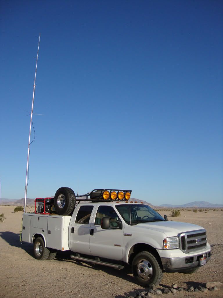

    dont forget a solid antenna mount!
    here's a cool design i did for a customer. it uses QD pins to lock the antenna in place and the bottom hinge point allows the antenna to be installed and hinged up . it makes a much easier time getting the antenna up and its a one person job now. fully raised it took the strongest wind gusts that plaster city could dish out, its so stout id chase with it up if there weren't power lines around the race course. beats the hell out of the tire holder mounts.
