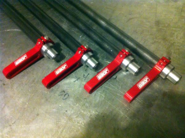

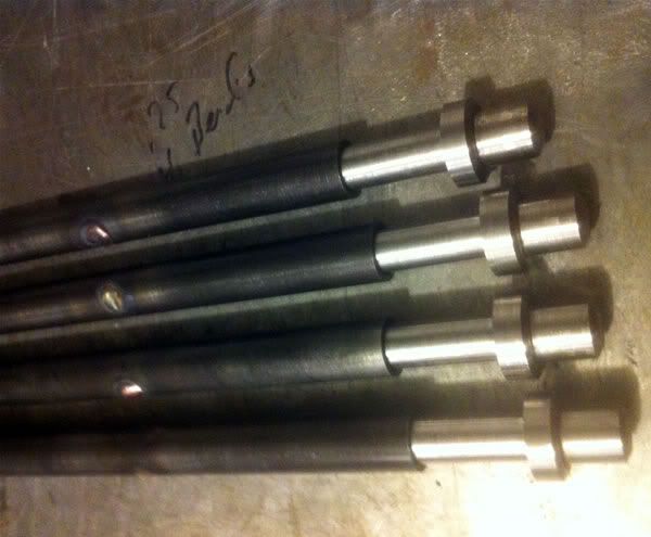

    Recently, I was talking to someone that related a similar situation and reminded me of this thread. They were saying after they rolled multiple times, they felt like that game you spin around a baseball bat and try to walk straight... They knew where everything was but trying to find it upside down (at night) took some thought. That had me thinking, simplicity is best.
    As far as the window net rods/brackets go, it is surprising how limited it is... basically, you need to combine two sets to get it similar top to bottom. However, if you have some scrap laying around, it is cheaper to make them rather than cobbling parts together. Buying the handles proved cheaper than making them.
    Now even a caveman can remove the nets... thanks.
