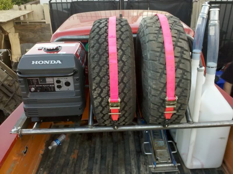

    i use a honda EU 3000 gen and a small craftsman gasless wire feed.
    i mounted the generator on the rack and the welder is strapped down under neath so i can grab and move it. i made a 15ft extension cable using 220v cable, to be sure it will handle anything.
    the welder works good for just about anything on my race truck, i just keep a MAP gas torch and turn welder up, and wire speed slow to make sure it penetrates well.
